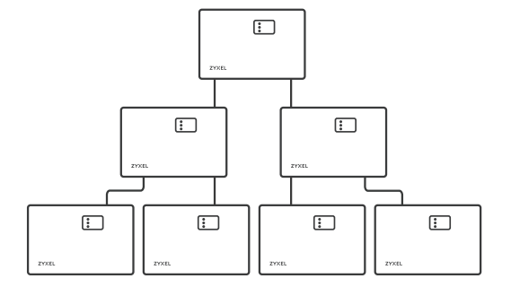

In addition, the MultiSite Repeater is built-in 2 expansion ports. To service a second site, simply connecting a second MultiSite Repeater’s input port to the first MultiSite Repeater’s expansion port via a LMR-400 coaxial cable, the 2nd MultiSite Repeater will receive a clear tri-band signal from the top MultiSite Repeater to cover its own zone. The distance of a LMR-400 coaxial cable can be up to 100 meters. A third site can be covered in the same way, via the second expansion port on the top MultiSite Repeater.
The unique and innovative design enables the MultiSite Repeater capable of cascading up to 7 nodes, ideal for multi-floor deployment, e.g. shopping malls, residential buildings, multi-floors offices/basements, hospitalities and warehouses.
