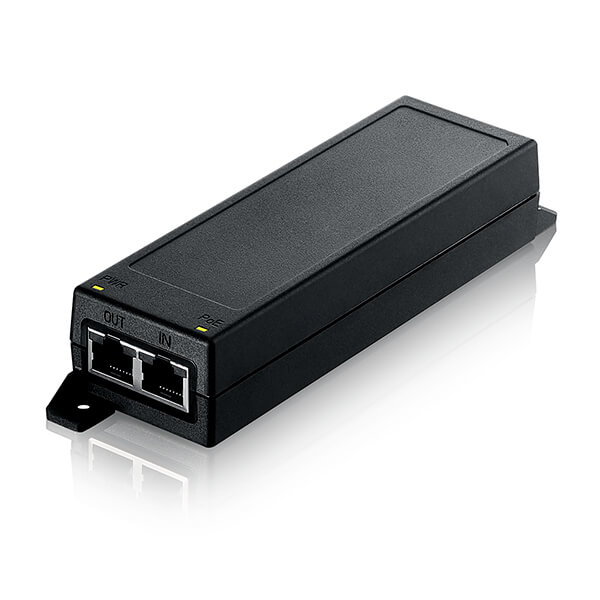

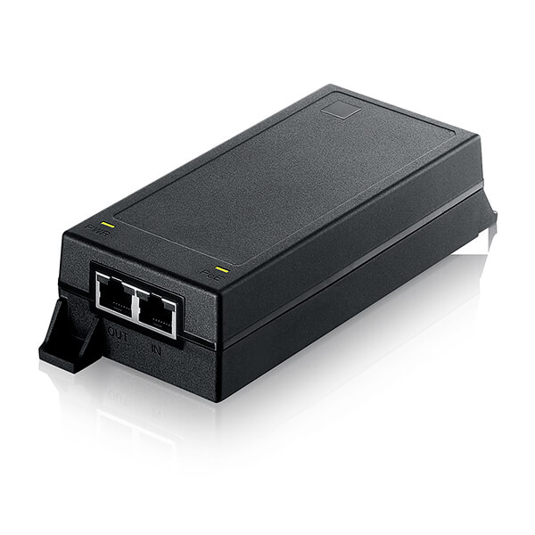

Zyxel PoE injectors are here to meet the increasing demand for connections to high-speed networking devices such as WiFi 7 and WiFi 6 APs, surveillance PTZ cameras, and advanced POS terminals. The PoE12-30W supports network speeds of up to 2.5Gbps, while both the PoE12-60W* and PoE12-90W support network speeds of up to 10Gbps.
*Limited support for Cat 6a, with cable lengths of up to 30 meters.
Higher Network Speed Boosts Network Performance
Larger Power Budget Powers More PD Devices
The PoE12-30W complies with the IEEE 802.3at PoE+ standard, while the PoE12-60W and PoE12-90W comply with the IEEE 802.3bt PoE++ standard to provide PoE power budgets of up to 30W, 60W, and 90W, respectively. They ensure interoperability and compatibility with other standard-based PoE-capable devices.
PoE12-90W
PoE12-90W
PoE12-60W
PoE12-60W
PoE12-30W
PoE12-30W
