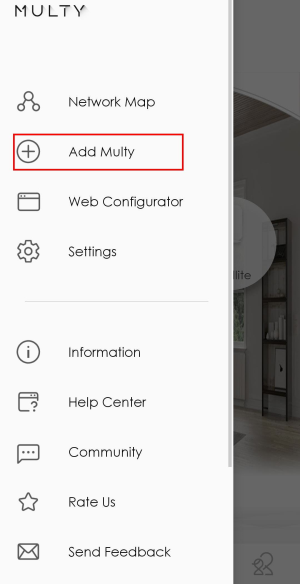

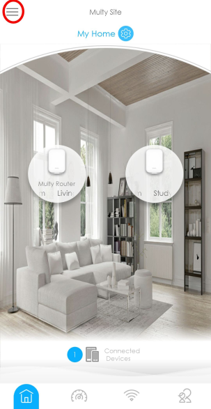

1 Tap the Menu icon in the upper-left to open the navigation panel. Tap Add Multy.

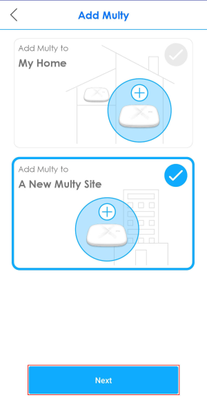

2 Tap A New Multy Site and Next to set up another Multy WiFi System.

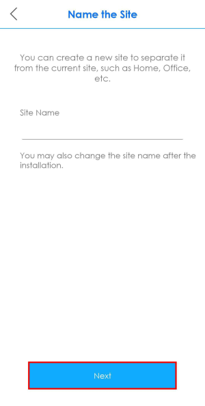

3 Enter a name for this new site. Tap Next and follow the prompt to finish the setup. See the instructions in Adding and Installing Your First Multy Device.

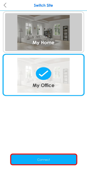

4 To manage a different Multy Site, tap Switch Site from the navigation panel.
5 Select the Multy Site you want to manage and then tap Connect.
*The Switch Site option is available only when you have more than one Multy Site.
