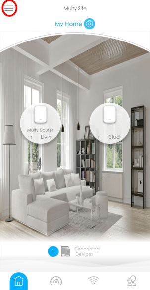

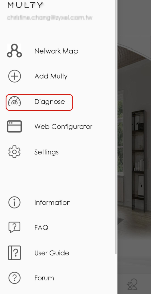

1 Tap the Menu icon in the upper-left to open the navigation panel. Tap Diagnose.

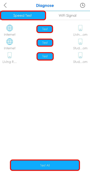

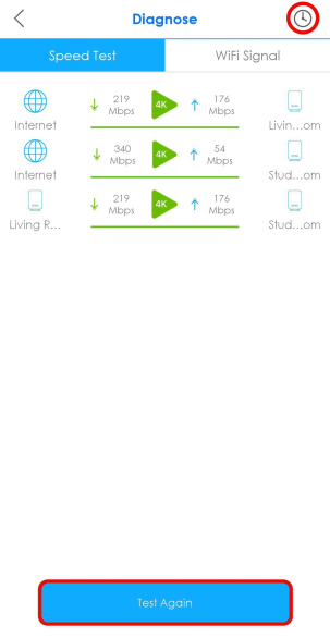

2 Tap Speed Test and the Test or Test All button to perform a test. The results will show data rates for both upstream and downstream traffic.
3 Tap
Test Again to show the

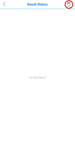

Test buttons. To view the previous test results, tap the History icon (
). You can tap the Remove icon (
) to delete all records.
