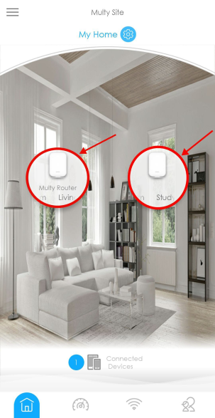

If a Multy Device is no longer in use, you can remove it from the Multy Site.

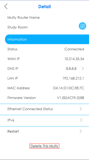

On the Multy Site screen, tap the Multy Device you want to remove. The Detail screen will be displayed. Tap Delete This Multy to remove the Multy Device.
Before pressing the
RESET button on the Multy Device, click
Delete This Multy on the
Detail screen.
If the primary Multy is removed on the
Detail screen, the assigned roles of the Mesh network, including the extenders, will be reset to the default settings.
