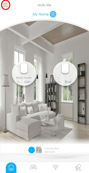

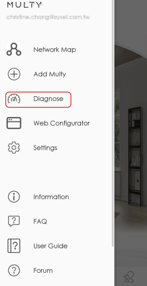

1 Tap the Menu icon in the upper-left to open the navigation panel. Tap Diagnose.

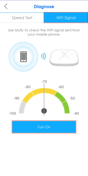

2 Tap WiFi Signal and then tap the Turn On button to perform a check. Tap Turn Off to stop the process. A decent WiFi signal would not go below –70 dBm (–70 dBm to –100 dBm).
