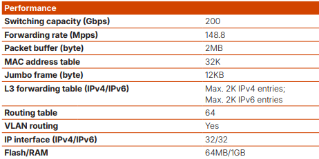

Let's calculate the full non-blocking bandwidth for this configuration: (24 ports x 2.5G + 4 ports x 10G) x 2 (duplex) = 200 Gbps. The fabric really is non-blocking - every port can be pushed to its maximum with no degradation.
Using a minimum frame size of 64 bytes, plus an 8-byte preamble and a 12-byte inter-frame gap, the minimum frame comes out to 84 bytes (672 bits). The line-rate formula gives 100 Gbit/s / 672 bits = 148.8 Mpps, matching the sum across all ports: 24 × 3.72 Mpps (2.5G ports) = 89.28 Mpps and 4 × 14.88 Mpps (10G ports) = 59.52 Mpps. In other words, the switch implements true line-rate forwarding on all interfaces at once - no marketing rounding.
One quirk worth keeping in mind: the packet buffer size is only 2 MB. For most access-point or surveillance-camera scenarios this won't be an issue, but as an aggregation switch funneling many 2.5G ports into a single 10G uplink, the small buffer can lead to packet loss during microbursts.
As for the rest of the specs - a 32K MAC table is plenty for an access switch, and support for 12 KB jumbo frames means it can be used in iSCSI/NAS scenarios.

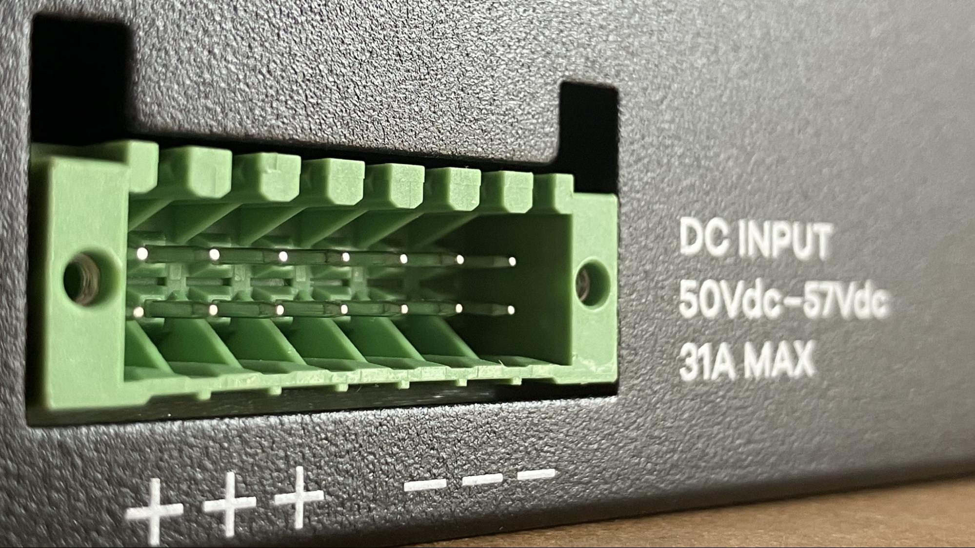

Zyxel is upfront that the choice is yours - add reserve power or expansion capacity only when you actually need it. The XMG2230-28HP has a trump card: an external DC input (50-57V DC) that lets you scale the PoE budget up to a solid 1440W.
Telecom carrier sites often already have a -48V DC infrastructure feeding radio relay stations, OLTs, DWDM equipment, and similar gear. That alone isn't enough for a direct connection, so you'd need a DC/DC boost converter, or an AC/DC power supply with sufficient headroom.
This option works in two modes:
  • Active-standby redundancy. Under normal conditions the switch runs on its built-in PSU; if that source is ever lost, the built-in ATS switches to the backup with no downtime.
  • PoE budget expansion. Every PoE port can be loaded at a full 60W with no shortfall - from heated outdoor PTZ cameras to industrial PCs.

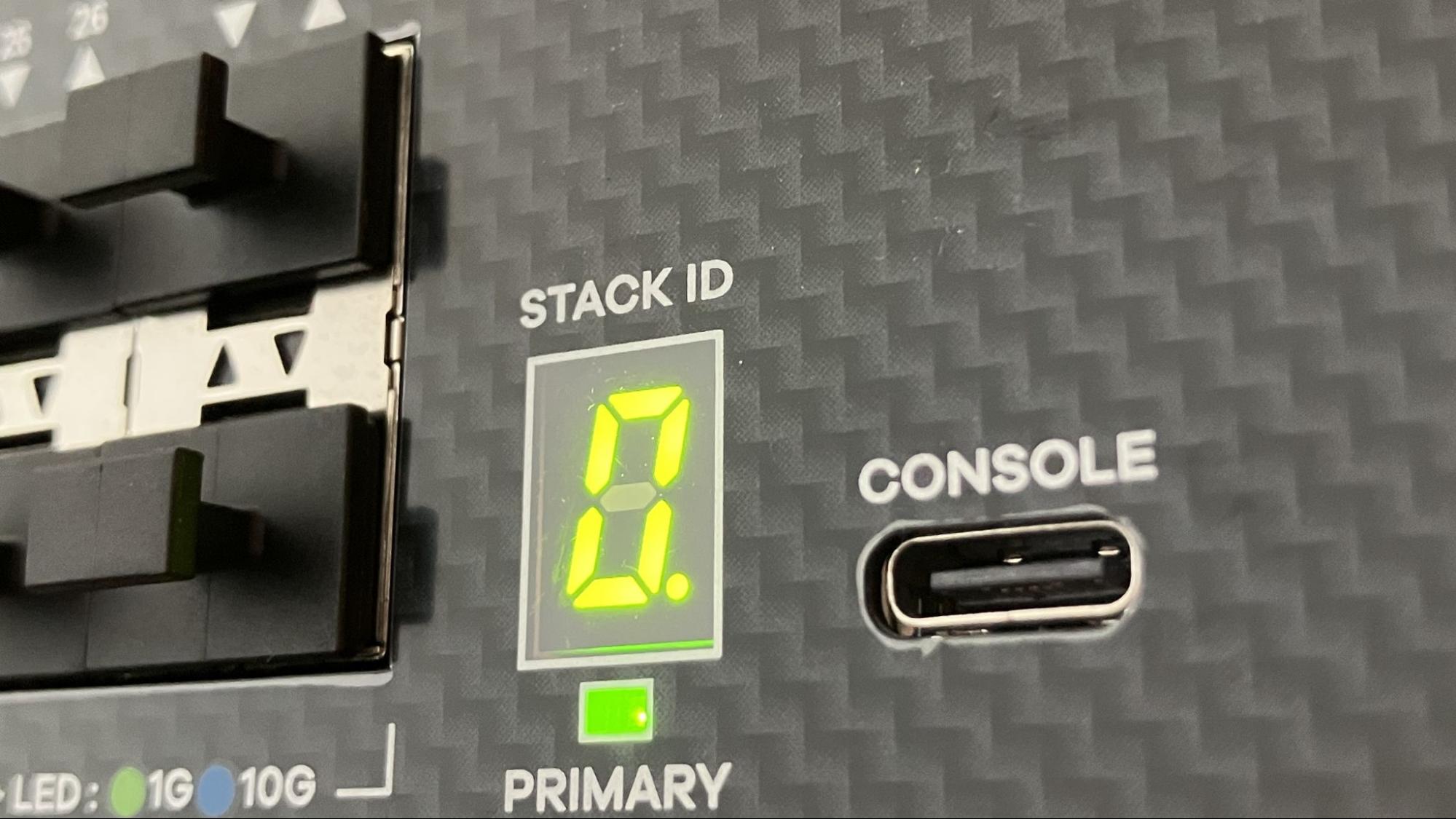

Stacking
The front panel features a 7-segment display for identifying a unit's number within a stack, along with a separate Primary LED that lets you instantly see whether the device is the stack master.
In October 2026, the switch is expected to receive firmware enabling stacking of up to 4 units. A corresponding Stacking option will appear in both the web interface and the CLI. As of this writing, the current firmware version (V2.00(ACNN.1) | 13.02.2026) doesn't yet include this option.
You'll be able to choose a configuration of 2 or 4 ports (on this model, the SFP+ 10G ports) to serve as stacking links - a case where the hardware's full capabilities get unlocked gradually through firmware updates.

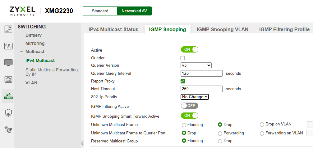

IGMP snooping
The way to avoid this is enabling IGMP snooping - a mechanism that lets the switch "eavesdrop" on passing IGMP packets to figure out who actually needs the multicast traffic and who doesn't. After that, the stream only gets forwarded to the ports that need it. Put simply, the switch starts making L2 decisions based on L3/L4 information - technically a violation of the OSI model, but an extremely useful one.
However, IGMP snooping doesn't operate in a vacuum on its own. Snooping tables can go stale, subscriptions can disappear, and the system can start behaving unpredictably. This is where fine-tuned QoS comes into play, prioritizing sync packets, audio streams, background traffic, and control frames. In mixed networks it's easy to end up in a situation where there's seemingly no congestion, yet the audio randomly starts "clicking".

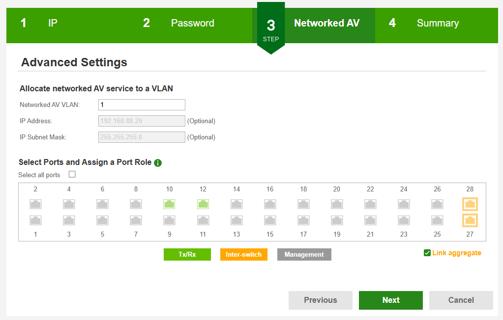

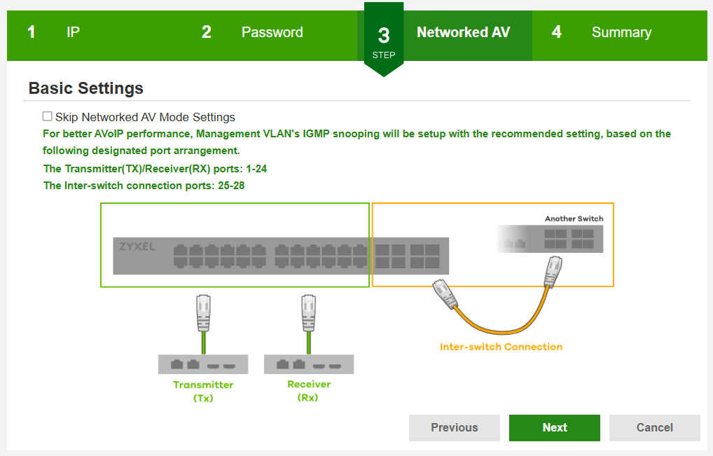

Networked AV configuration
The Simplified
Configuration Mode
This is exactly where Networked AV mode comes to the rescue. Instead of a full menu with dozens of parameters, the engineer is offered a configuration wizard that implements a set of common scenarios and prepares the network for AV-over-IP protocols, without needing to dig through the CLI.
This is reminiscent of airline pilot checklists: step-by-step procedures that let you take off with confidence that every system is engaged and working properly. Networked AV works the same way - it only highlights the parameters that actually matter for AVoIP configuration. The wizard is essentially that same checklist, just in dialog form.
Of course, none of this removes the need to think about network topology, redundancy, and traffic routing. But for everyday AV-integrator scenarios, this configuration mode helps avoid the most common first-run mistakes and is far more approachable than the unforgiving CLI of dedicated AV hardware.

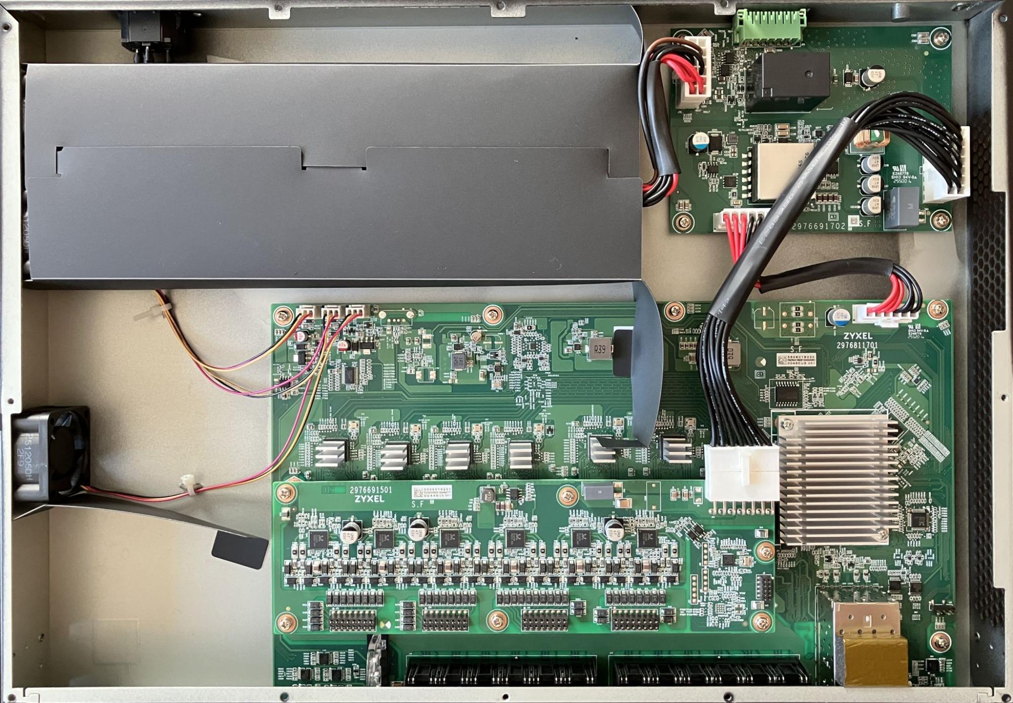

As always in our reviews, we're not shy about showing what's inside the device. Removing the top cover takes about 5 minutes and 12 Philips screws. Inside, we find not one board but several neatly laid-out PCBs, split across different zones.
Logic, PoE, and the power section each live in their own space. The power supply, which runs hot and is "noisy" in terms of interference, was placed as far as possible from the sensitive switching logic.
Inside view
Inside View

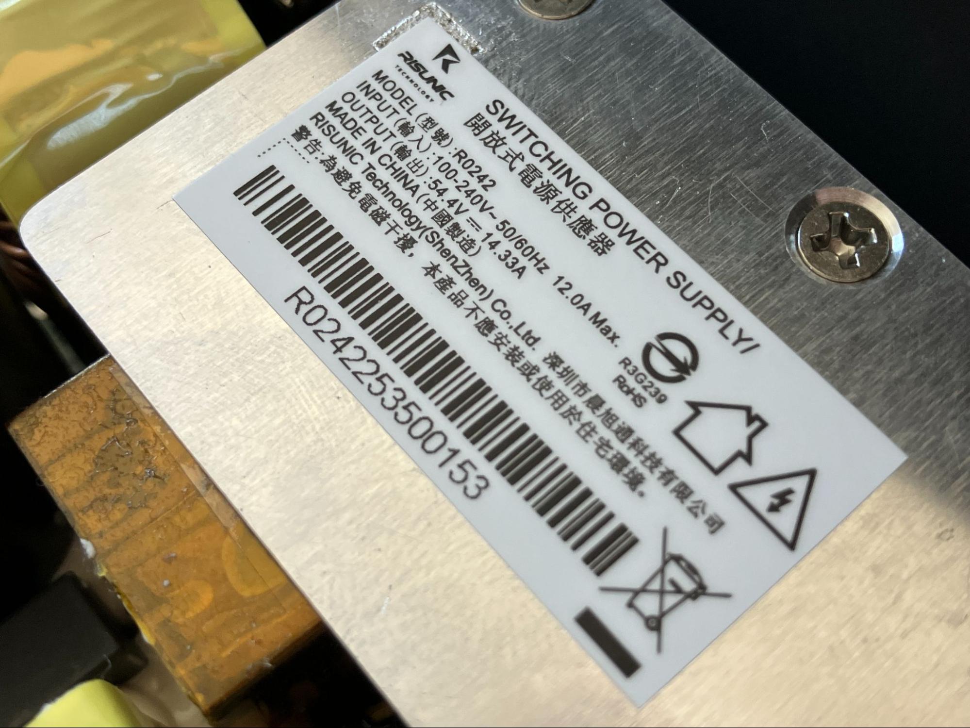

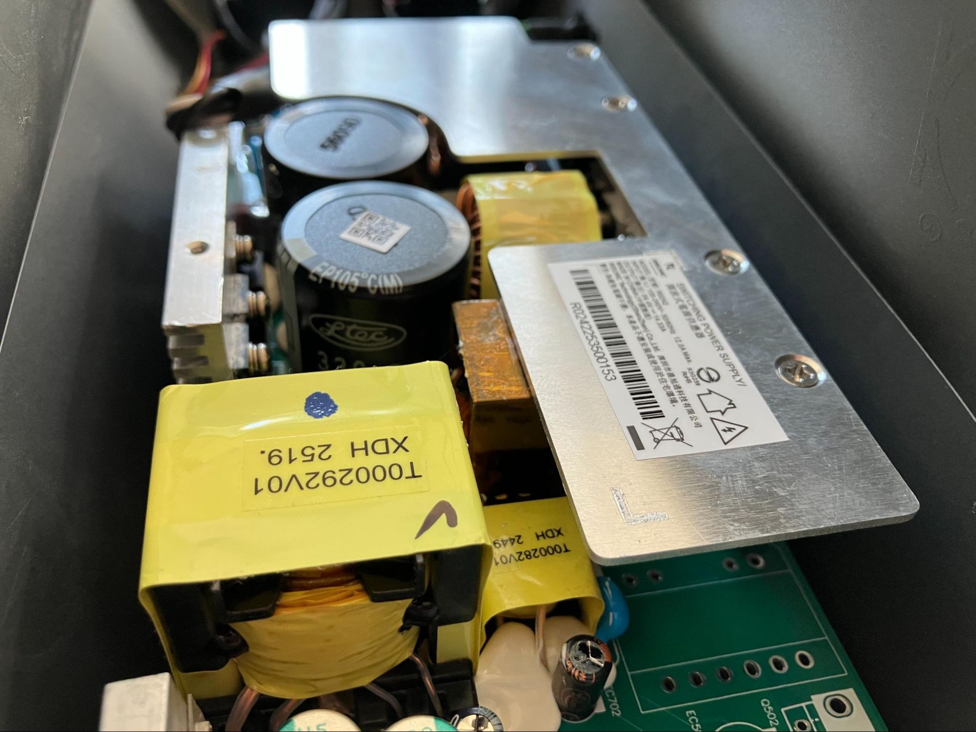

The entire upper-left section is dedicated to the built-in RISUNIC R0242 power supply.
Internal view - RISUNIC R0242
RISUNIC R0242 Power Supply
This is a fairly typical open-frame PCBA, honestly delivering roughly 780W, of which 700W goes to the PoE budget while the rest is consumed by the switch itself and conversion losses.
Ltec 330mF 450V capacitors
Capacitors & Transformers
Nothing exotic here - a well-built, densely packed PSU with Ltec 330mF 450V, 105°C capacitors. Nearby are the transformers and heatsinks on the switching transistors.

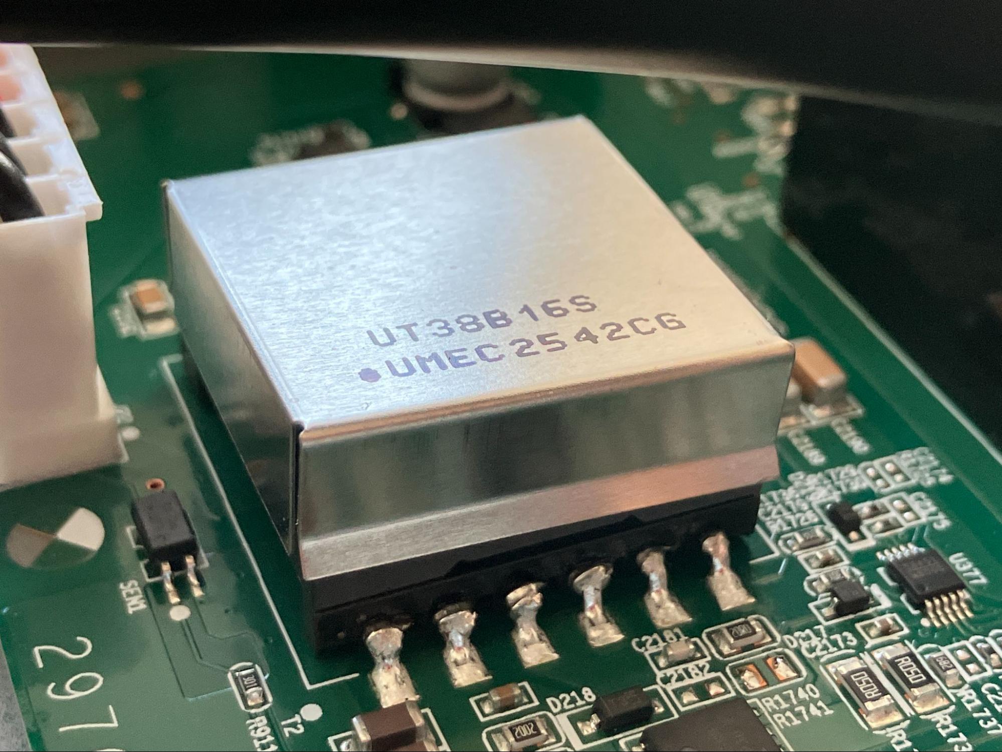

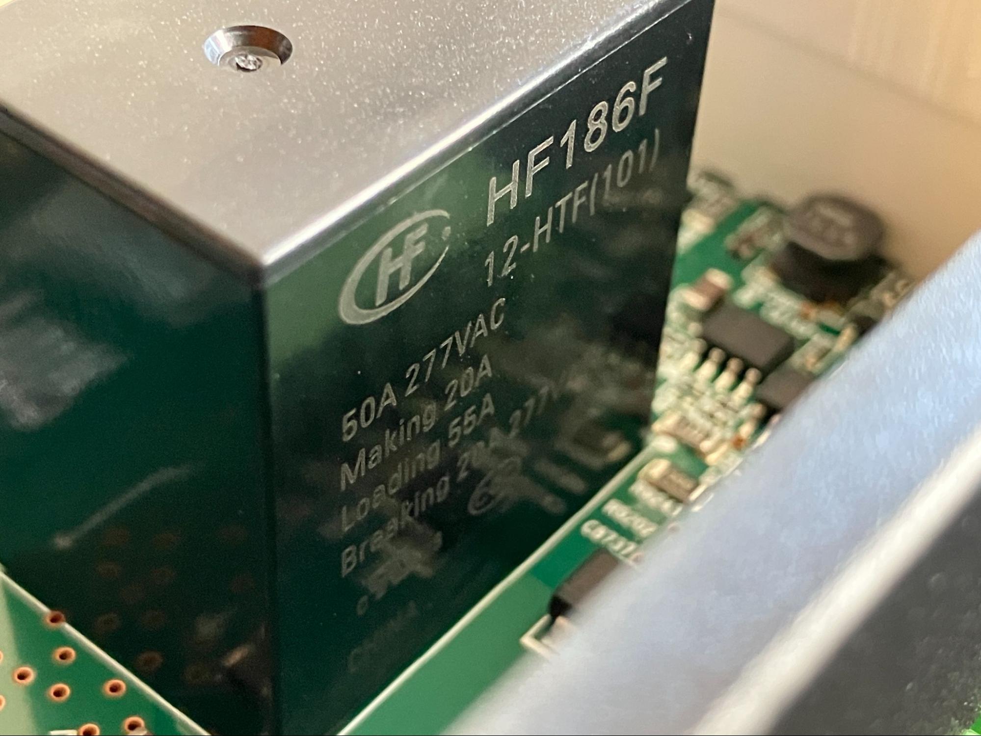

External DC board - Hongfa HF186F
External DC Board
A separate board handles the external DC input, which lets you push the PoE budget up to 1440W. The star here is a Hongfa HF186F relay rated at 50A / 277VAC - likely part of the failover circuit that allows instant switching between power sources.
DC board - UMEC UT38B16S
UMEC UT38B16S Transformer
It's accompanied by a shielded UMEC UT38B16S transformer, a common-mode choke, and various types of capacitors - the typical "gentleman's kit" needed to sustain a 60W-per-port load.

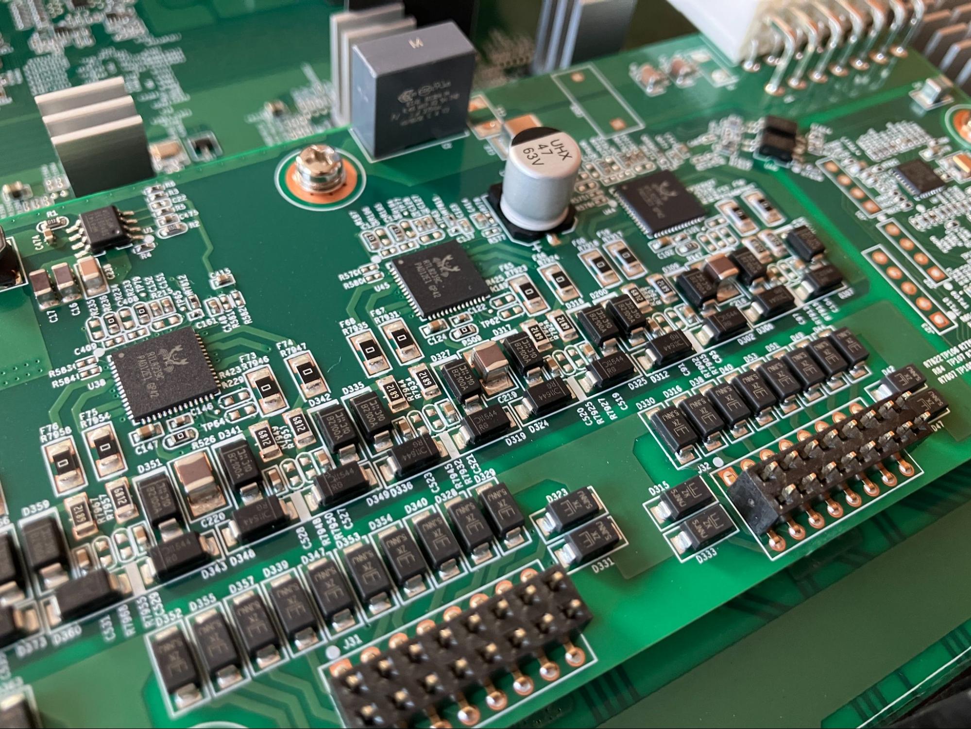

PoE section
PoE Daughterboard
The most interesting part sits on the main board and on a "second floor" PoE section mounted on top of it.

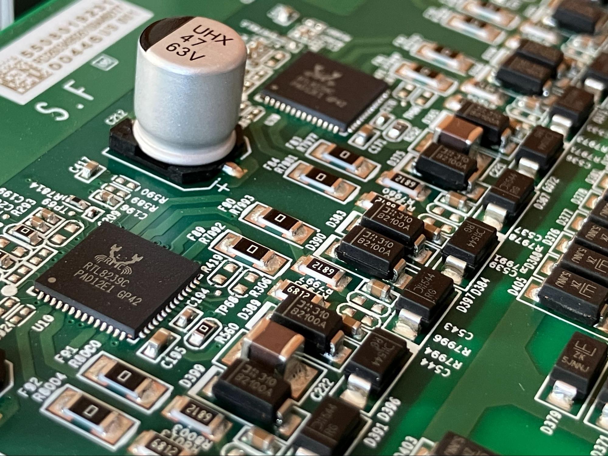

PSE Realtek RTL8239
Realtek RTL8239 PSE Controllers
Power distribution is handled by Realtek RTL8239 PSE controllers, each one serving its own group of ports. Right next to them are densely packed fields of B2100A Schottky protection diodes, current-sensing resistors, and isolation components.

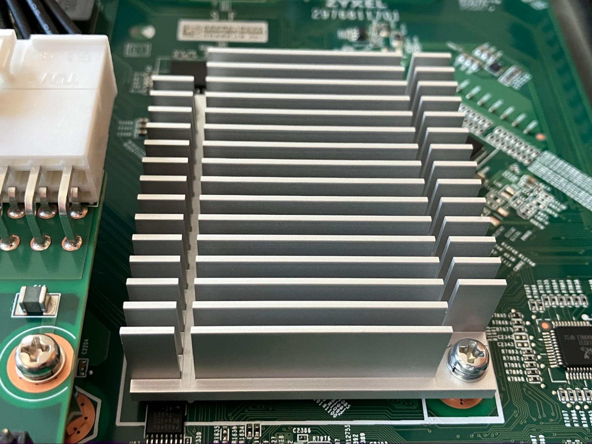

The star of the show - the switching ASIC - isn't something you can just look at. It's hidden under a massive finned aluminium heatsink, mounted not on a soft thermal pad but on a thermal compound that essentially glues the die to the heatsink.
Since all the PoE circuitry is built around Realtek chips, there's almost certainly an SoC from the RTL931x family hiding underneath - a high-performance Layer 3 stacking controller with a built-in dual-core MIPS processor.

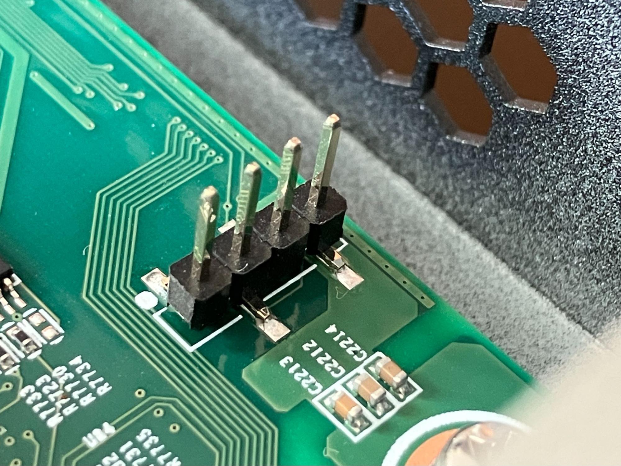

UART connector
UART Header
One nice detail for anyone who likes to tinker: there's a populated UART header on the board, but it's no longer accessible without opening the case (unlike on the Zyxel XMG1915-18EP).

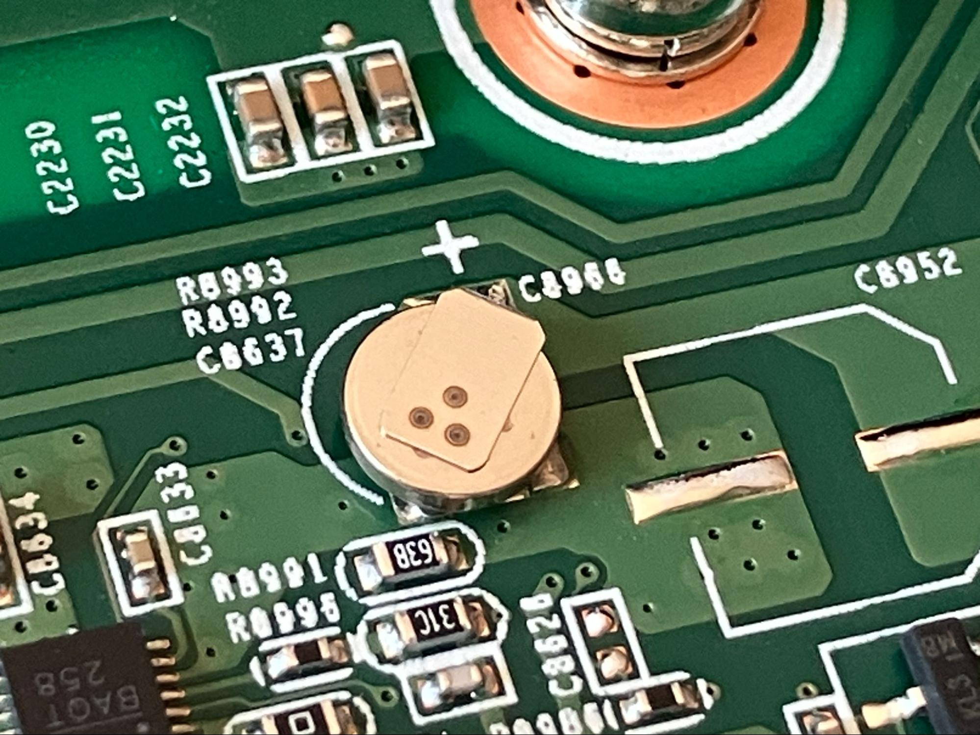

Internal - coin cell battery
RTC Battery
There's also room on the board for an SMD "coin cell" for the RTC (Real-Time Clock), so the clock survives power loss and reboots just fine.
