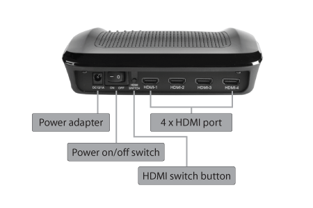

Transmitter
- 32 antenna array with auto tracing
- A/V input: four HDMI 1.4a ports
- Button/Switch
- HDMI switch button
- Power on/off switch
- LED indicators
- No connection: blinking
- Connection associated: steady
- Power supply
- Input: 120 V ~ 240 V AC
- Output: 12 V DC, 1.0 A
- Power consumption
- Full operation: 9 watt max.
- Power-saving mode: 4.0 watt max.

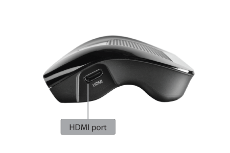

Receiver
- A/V output: one HDMI 1.4a port
- Switch
- LED indicators
- Power supply
- Output: 5 V DC, 2.0 A
- Power consumption
- Full operation: 6.5 watt max.
- Power-saving mode: 2.6 watt max.
